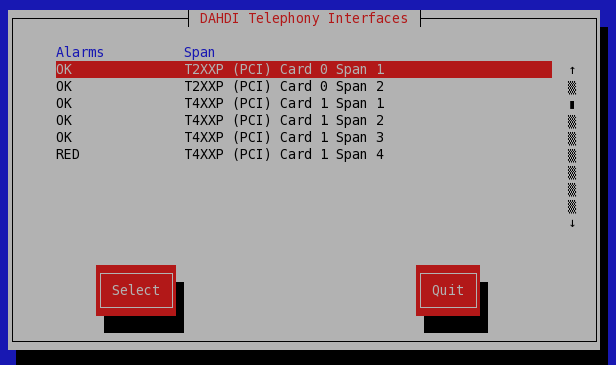

*CLI> dahdi show status
Description Alarms IRQ bpviol CRC4 Fra Codi Options LBO
T2XXP (PCI) Card 0 Span 1 OK 0 0 0 CCS HDB3 CRC4 0 db (CSU)/0-133 feet (DSX-1)
T2XXP (PCI) Card 0 Span 2 OK 0 0 0 CCS HDB3 CRC4 0 db (CSU)/0-133 feet (DSX-1)
T4XXP (PCI) Card 1 Span 1 OK 0 0 0 CCS HDB3 CRC4 0 db (CSU)/0-133 feet (DSX-1)
T4XXP (PCI) Card 1 Span 2 OK 0 0 0 CCS HDB3 CRC4 0 db (CSU)/0-133 feet (DSX-1)
T4XXP (PCI) Card 1 Span 3 OK 0 0 0 CCS HDB3 CRC4 0 db (CSU)/0-133 feet (DSX-1)
T4XXP (PCI) Card 1 Span 4 RED 0 0 0 CCS HDB3 CRC4 0 db (CSU)/0-133 feet (DSX-1)
D210 + D410 = total 6 E1 ports, 186 channels

DAHDI/10-1 musiconhold@app-blac Up MusicOnHold()
DAHDI/72-1 *43@from-internal:4 Up Echo()
DAHDI/9-1 musiconhold@app-blac Up MusicOnHold()
DAHDI/71-1 *43@from-internal:4 Up Echo()
DAHDI/8-1 musiconhold@app-blac Up MusicOnHold()
DAHDI/70-1 *43@from-internal:4 Up Echo()
DAHDI/7-1 musiconhold@app-blac Up MusicOnHold()
DAHDI/69-1 *43@from-internal:4 Up Echo()
DAHDI/6-1 musiconhold@app-blac Up MusicOnHold()
DAHDI/68-1 *43@from-internal:4 Up Echo()
DAHDI/5-1 musiconhold@app-blac Up MusicOnHold()
DAHDI/67-1 *43@from-internal:4 Up Echo()
DAHDI/4-1 musiconhold@app-blac Up MusicOnHold()
DAHDI/66-1 *43@from-internal:4 Up Echo()
DAHDI/3-1 musiconhold@app-blac Up MusicOnHold()
DAHDI/65-1 *43@from-internal:4 Up Echo()
DAHDI/2-1 musiconhold@app-blac Up MusicOnHold()
DAHDI/64-1 *43@from-internal:4 Up Echo()
DAHDI/1-1 musiconhold@app-blac Up MusicOnHold()
DAHDI/63-1 *43@from-internal:4 Up Echo()
101 active channels
101 active calls
120 calls processed
Вызов с двух первых Е1 портов терминируется на музыку во вторых двух Е1 портах. 60% загрузка системы
