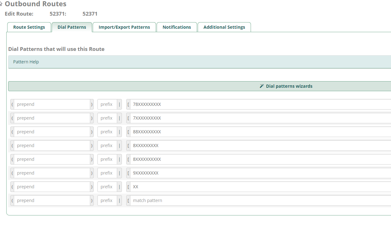

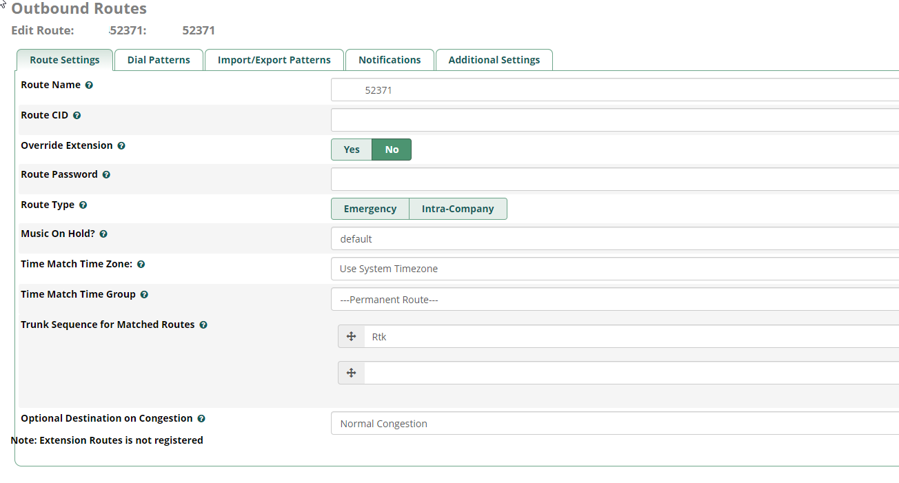

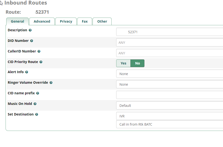

Ну настройки часть 2
Outbound Routes ч2
Outbound Routes ч2
Outbound Routes
Outbound Routes
Inbound Routes
Inbound Routes
