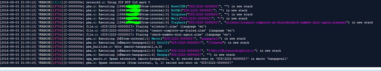

Логи астериска при попытке звонка
Скрин логов астериска
[2016-09-03 21:05:12] VERBOSE[16119][C-0000000e] netsock2.c: Using SIP RTP CoS mark 5
[2016-09-03 21:05:12] VERBOSE[19756][C-0000000e] pbx.c: Executing [18961ххххххх@from-internal:1] ResetCDR("SIP/2222-00000017", "") in new stack
[2016-09-03 21:05:12] VERBOSE[19756][C-0000000e] pbx.c: Executing [18961ххххххх@from-internal:2] NoCDR("SIP/2222-00000017", "") in new stack
[2016-09-03 21:05:12] VERBOSE[19756][C-0000000e] pbx.c: Executing [18961ххххххх@from-internal:3] Progress("SIP/2222-00000017", "") in new stack
[2016-09-03 21:05:12] VERBOSE[19756][C-0000000e] pbx.c: Executing [18961ххххххх@from-internal:4] Wait("SIP/2222-00000017", "1") in new stack
[2016-09-03 21:05:13] VERBOSE[19756][C-0000000e] pbx.c: Executing [18961ххххххх@from-internal:5] Playback("SIP/2222-00000017", "silence/1&cannot-complete-as-dialed&check-number-dial-again,noanswer") in new stack
[2016-09-03 21:05:13] VERBOSE[19756][C-0000000e] file.c: <SIP/2222-00000017> Playing 'silence/1.ulaw' (language 'en')
[2016-09-03 21:05:14] VERBOSE[19756][C-0000000e] file.c: <SIP/2222-00000017> Playing 'cannot-complete-as-dialed.ulaw' (language 'en')
[2016-09-03 21:05:15] VERBOSE[19756][C-0000000e] file.c: <SIP/2222-00000017> Playing 'check-number-dial-again.ulaw' (language 'en')
[2016-09-03 21:05:15] VERBOSE[19756][C-0000000e] pbx.c: Executing [h@from-internal:1] Macro("SIP/2222-00000017", "hangupcall") in new stack
[2016-09-03 21:05:15] VERBOSE[19756][C-0000000e] pbx.c: Executing [s@macro-hangupcall:1] GotoIf("SIP/2222-00000017", "1?theend") in new stack
[2016-09-03 21:05:15] VERBOSE[19756][C-0000000e] pbx_builtins.c: Goto (macro-hangupcall,s,3)
[2016-09-03 21:05:15] VERBOSE[19756][C-0000000e] pbx.c: Executing [s@macro-hangupcall:3] ExecIf("SIP/2222-00000017", "0?Set(CDR(recordingfile)=)") in new stack
[2016-09-03 21:05:15] VERBOSE[19756][C-0000000e] pbx.c: Executing [s@macro-hangupcall:4] Hangup("SIP/2222-00000017", "") in new stack
[2016-09-03 21:05:15] VERBOSE[19756][C-0000000e] app_macro.c: Spawn extension (macro-hangupcall, s, 4) exited non-zero on 'SIP/2222-00000017' in macro 'hangupcall'
[2016-09-03 21:05:15] VERBOSE[19756][C-0000000e] pbx.c: Spawn extension (from-internal, h, 1) exited non-zero on 'SIP/2222-00000017'

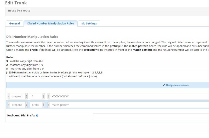

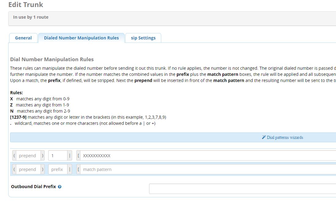

Настройки диал паттернс в транке:
prepend 1, prefix пусто, match pattern XXXXXXXXXXX
Диал паттерн транк
Диал паттерн транк

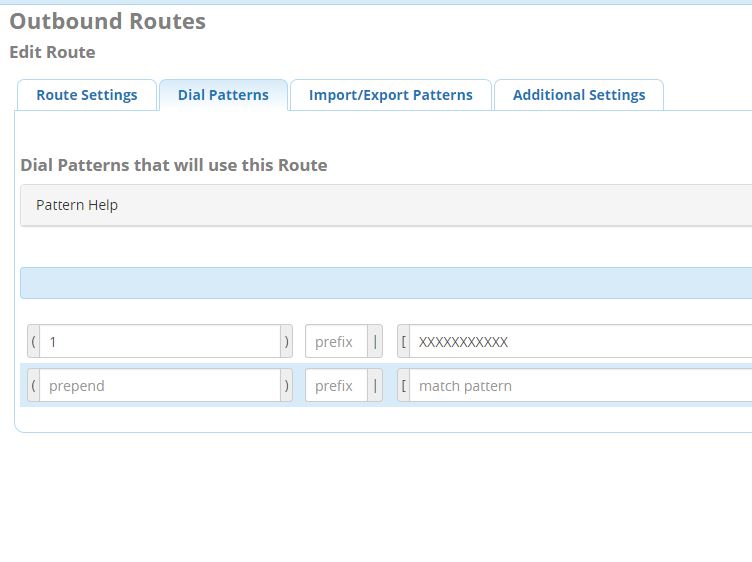

В исходящем маршруте тоже прописал диалплан аналогично транку.

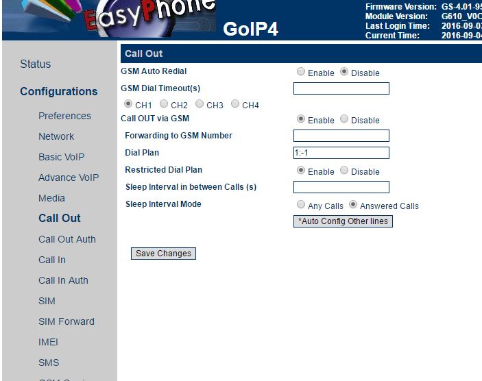

Настройки goip для исходящих:
Goip исходящие
Goip исходящие
В call out auth - no auth
На шлюзе пробовал убирать forwarding to gsm number (сейчас стоит реальный номер симки) - не помогло.

А где скрины/логи с командой Dial?
Forwarding to GSM num -> empty
GSM Auto redial -> disable

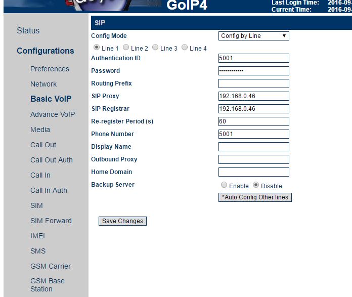

И выложите скрин страницы Basic Voip

судя по логу
у Вас просто нет исходящего маршрута.
есть преобразование номера в транке.
prepend 1 - единичку транк добавить если увидит, что через него бежит XXXXXXXXXXX-значный номер, prefix - соответственно, отрежет. Раз Вы пускали 18961ххххххх, значит хотели с префиксом 1, то есть ровно наоборот надо было 1 - в префиксе.
Вы набираете 18961ххххххх - то есть уже с единичкой, и то есть нет исходящего маршрута, и нет понимания как сделать.
Надо в исходящих маршрутах сделать дефолтный маршрут Х. и указать в качестве транка - ваш GoIP/
И набирать, и смотреть что попадает туда, это будет видно по строке Dial(SIP/GoIP/89612345678,300,tT) в логе.

ded, правильно ли я понимаю. Сперва звонок исходящий идет через транк, в транке такой диал:
номер в формате XXXXXXXXXXX, набираю я 1XXXXXXXXXX. Транк обрубает единицу и вызывает исходящий маршрут (в маршруте указал транк). Диал маршрута:
На этот маршрут приходит номер без единицы уже , т.е. XXXXXXXXXXX, в нем я добавляю единицу снова, чтобы послать на шлюз на 1 симку в формате 1XXXXXXXXXXX, затем на шлюзе убираю единицу:
При таком раскладе при звонке то же самое:
[2016-09-04 18:21:09] VERBOSE[2136][C-0000000f] netsock2.c: Using SIP RTP CoS mark 5
[2016-09-04 18:21:09] VERBOSE[19922][C-0000000f] pbx.c: Executing [18961ххххххх@from-internal:1] ResetCDR("SIP/2222-00000015", "") in new stack
[2016-09-04 18:21:09] VERBOSE[19922][C-0000000f] pbx.c: Executing [18961ххххххх@from-internal:2] NoCDR("SIP/2222-00000015", "") in new stack
[2016-09-04 18:21:09] VERBOSE[19922][C-0000000f] pbx.c: Executing [18961ххххххх@from-internal:3] Progress("SIP/2222-00000015", "") in new stack
[2016-09-04 18:21:09] VERBOSE[19922][C-0000000f] pbx.c: Executing [18961ххххххх@from-internal:4] Wait("SIP/2222-00000015", "1") in new stack
[2016-09-04 18:21:10] VERBOSE[19922][C-0000000f] pbx.c: Executing [18961ххххххх@from-internal:5] Playback("SIP/2222-00000015", "silence/1&cannot-complete-as-dialed&check-number-dial-again,noanswer") in new stack
[2016-09-04 18:21:10] VERBOSE[19922][C-0000000f] file.c: <SIP/2222-00000015> Playing 'silence/1.ulaw' (language 'en')
[2016-09-04 18:21:11] VERBOSE[19922][C-0000000f] file.c: <SIP/2222-00000015> Playing 'cannot-complete-as-dialed.ulaw' (language 'en')
[2016-09-04 18:21:12] VERBOSE[19922][C-0000000f] file.c: <SIP/2222-00000015> Playing 'check-number-dial-again.ulaw' (language 'en')
[2016-09-04 18:21:12] VERBOSE[19922][C-0000000f] pbx.c: Executing [h@from-internal:1] Macro("SIP/2222-00000015", "hangupcall") in new stack
[2016-09-04 18:21:12] VERBOSE[19922][C-0000000f] pbx.c: Executing [s@macro-hangupcall:1] GotoIf("SIP/2222-00000015", "1?theend") in new stack
[2016-09-04 18:21:12] VERBOSE[19922][C-0000000f] pbx_builtins.c: Goto (macro-hangupcall,s,3)
[2016-09-04 18:21:12] VERBOSE[19922][C-0000000f] pbx.c: Executing [s@macro-hangupcall:3] ExecIf("SIP/2222-00000015", "0?Set(CDR(recordingfile)=)") in new stack
[2016-09-04 18:21:12] VERBOSE[19922][C-0000000f] pbx.c: Executing [s@macro-hangupcall:4] Hangup("SIP/2222-00000015", "") in new stack
[2016-09-04 18:21:12] VERBOSE[19922][C-0000000f] app_macro.c: Spawn extension (macro-hangupcall, s, 4) exited non-zero on 'SIP/2222-00000015' in macro 'hangupcall'
[2016-09-04 18:21:12] VERBOSE[19922][C-0000000f] pbx.c: Spawn extension (from-internal, h, 1) exited non-zero on 'SIP/2222-00000015'
Строки Dial(SIP/GoIP/89612345678,300,tT) в логах нет. Или я смотрю не туда? но вроде туда: во freepbx reports->asterisk logfiles

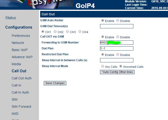

gland, Понимания в астериске действительно нет, использовал много вариантов потому как уже отчаялся и в нете использовал уже любые советы/настройки. Что Вы подразумеваете под логами с командой dial? SSH доступа к сожалению нет, во FreePBX в Asterisk CLI нашел команду dialplan show. Там очень длинная портянка, ее выложить?
На шлюзе Forwarding to GSM убрал, GSM Auto redial - disable.
Скрин Basic VoIP:
В статусе VoIP - Y.
пока вы не найдете эту строку - звонков не будет .

Почитайте, что такое Routing Prefix в Basic VoIP и попробуйте еще раз :)

2. Вкладка BasicVoip. Routing prefix - это та цифра. которую вы добавляете перед набираемым номером. Обычно ch1 = 1, ch2 =2 , что потом вы УЖЕ обрезаете в CallOut (1:-1 и тд)
