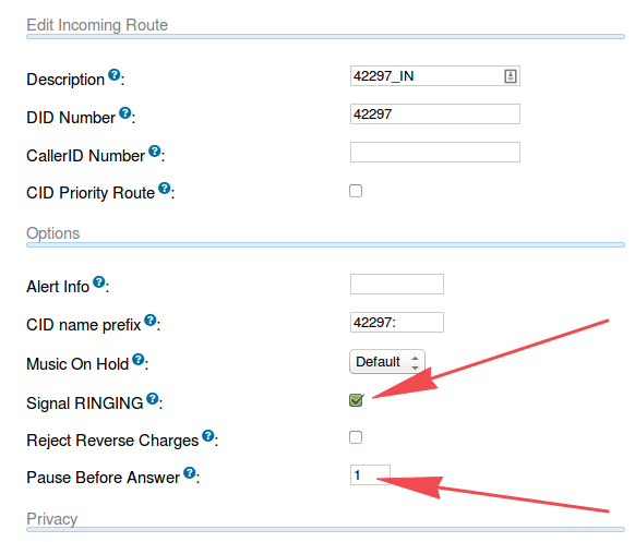

Re: С PRI шлюза Yeastar NeoGate TE100 не принимает мобильные
ради эксперимента поставьте где-нить перед Answer и последующим IVR
Ringing()
Wait(1)

Я вижу что обрыв связи вот тут:
    -- Called trunk-sip.telelan.net.ua/42297
    -- SIP/trunk-sip.telelan.net.ua-00000028 answered DAHDI/6-1
q931.c:6078 q931_connect: Call 11946 enters state 8 (Connect Request).  Hold state: Idle
TE100*CLI>
> DL-DATA request
> Protocol Discriminator: Q.931 (8)  len=14
> TEI=0 Call Ref: len= 2 (reference 11946/0x2EAA) (Sent to originator)
> Message Type: CONNECT (7)
TEI=0 Transmitting N(S)=106, window is open V(A)=105 K=7
[ span number: 1 ]
> [18 03 a9 83 86]
> Channel ID (len= 5) [ Ext: 1  IntID: Implicit  Other(PRI)  Spare: 0  Exclusive  Dchan: 0
>                       ChanSel: As indicated in following octets
>                       Ext: 1  Coding: 0  Number Specified  Channel Type: 3
>                       Ext: 1  Channel: 6 Type: CPE]
> [1e 02 81 82]
> Progress Indicator (len= 4) [ Ext: 1  Coding: CCITT (ITU) standard (0)  0: 0  Location: Private network serving the local user (1)
>                               Ext: 1  Progress Description: Called equipment is non-ISDN. (2) ]
[ span number: 1 ]
< Protocol Discriminator: Q.931 (8)  len=5
< TEI=0 Call Ref: len= 2 (reference 11946/0x2EAA) (Sent from originator)
< Message Type: CONNECT ACKNOWLEDGE (15)
Received message for call 0x22e968 on link 0x48ed48 TEI/SAPI 0/0
q931.c:9098 post_handle_q931_message: Call 11946 enters state 10 (Active).  Hold state: Idle
[ span number: 1 ]
< Protocol Discriminator: Q.931 (8)  len=9
< Message Type: DISCONNECT (69)
< [08 02 81 90]
< Cause (len= 4) [ Ext: 1  Coding: CCITT (ITU) standard (0)  Spare: 0  Location: Private network serving the local user (1)
<                  Ext: 1  Cause: Normal Clearing (16), class = Normal Event (1) ]
-- Processing IE 8 (cs0, Cause)
-- Found active call: 0x22e968 cref:11946
q931.c:9321 post_handle_q931_message: Call 11946 enters state 12 (Disconnect Indication).  Hold state: Idle
    -- Channel 0/6, span 2 got hangup request, cause 16
Но его причины не понимаю. Подскажите, пожалуйста.

Vlad1983 писал(а):ради эксперимента
Ringing()
Wait(1)
И знаете что?.. Да!!! ЗАРАБОТАЛО!!! :)
Спасибо большое!!!
Обьясните, пожалуйста "механику" проблемы? Почему мобильному аплинку нужно RINGING?
Через веб-морду, на FreePBX это делается в настройках входящего маршрута (см. скриншот):
Причем в подсказке к RINGING чесно указано:
Some devices or providers require RINGING to be sent before ANSWER. You'll notice this happening if you can send calls directly to a phone, but if you send it to an IVR, it won't connect the call.
Но при тестировании данной функции я не указывал "Wait", а это оказалось обязательным условием.
Еще раз большое спасибо! :)
P.S.
На форуме принято менять тему поста на [РЕШЕНО]? Я бы изменил тему немного и добавил.
просто иногда оператору не нравится почти мгновенный CONNECT после SETUP
