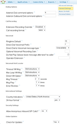

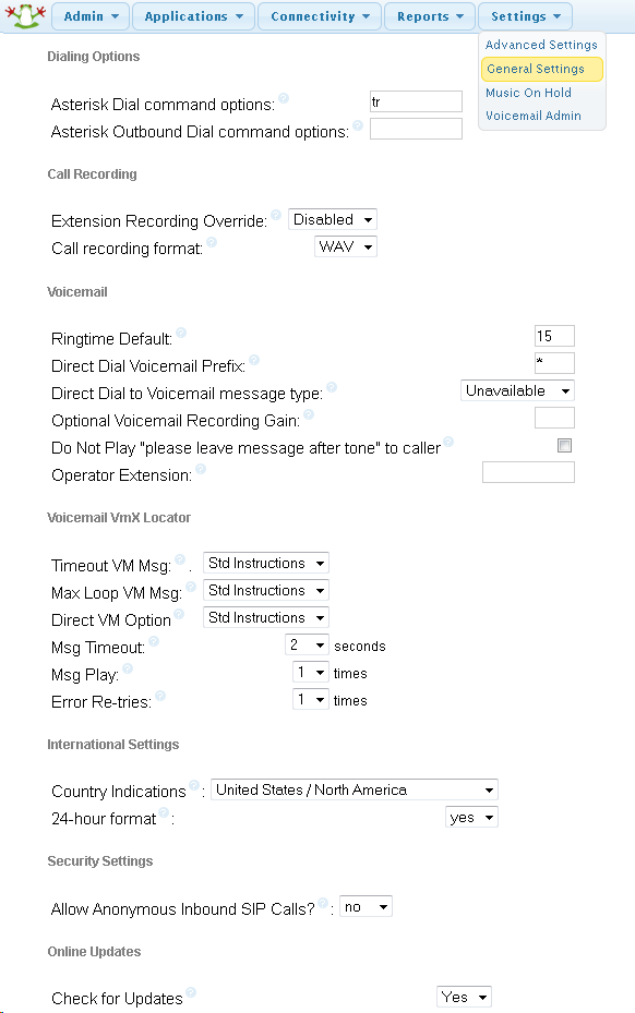

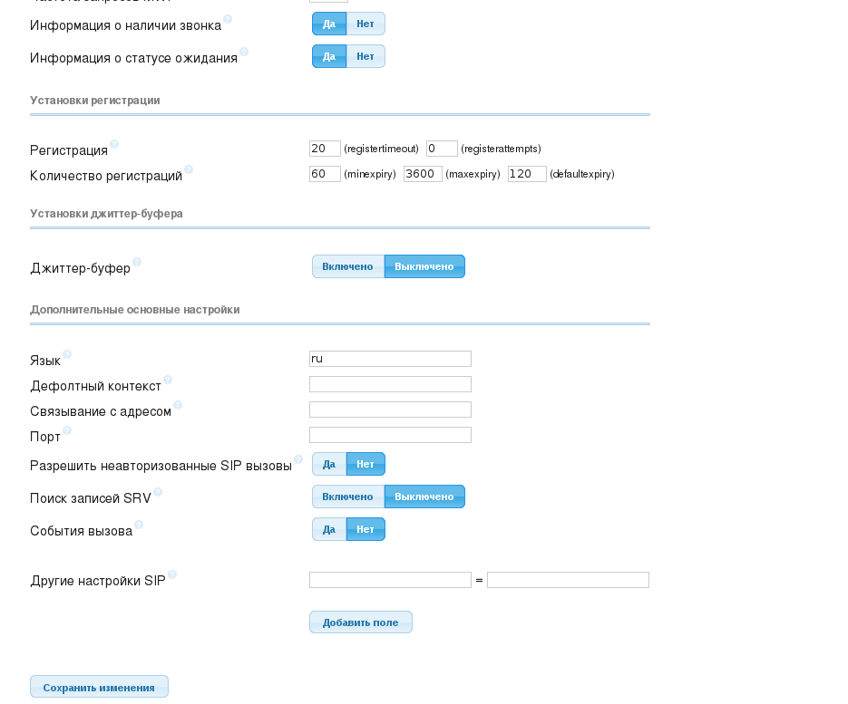

Сообщение PhoenixUA »
Не совсем понял где это.
Скриншот General Settings во вложении.

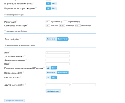

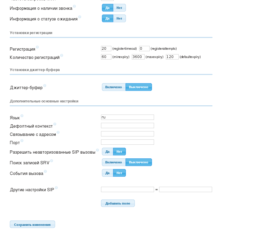

Сообщения: 15688
Re: Определенный custom context при добавлении extension
Не Advanced Settings, а SIP Settings.
Указать свой дефолтный контекст.

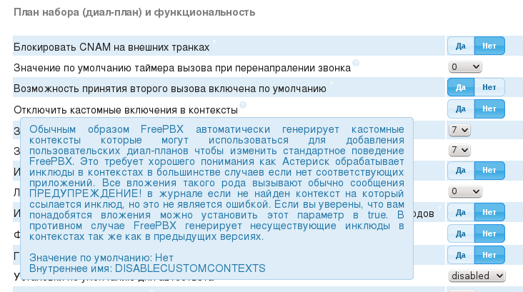

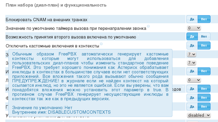

Сообщения: 15688
Там есть подсказки:
Normally FreePBX auto-generates a custom context that may be usable for adding custom dialplan to modify the normal behavior of FreePBX. It takes a good understanding of how Asterisk processes these includes to use this and in many of the cases, there is no useful application. All includes will result in a WARNING in the Asterisk log if there is no context found to include though it results in no errors. If you know that you want the includes, you can set this to true. If you comment it out FreePBX will revert to legacy behavior and include the contexts.
Default Value: False
PhoenixUA
Сообщения: 4
Зарегистрирован: 13 авг 2013, 14:43
ded писал(а):Не Advanced Settings, а SIP Settings.
Похоже этот параметр для входящих звонков, а мне надо для исходящих.
Default Context
(asterisk:context)
- Default context for incoming calls if not specified. PBXact sets this to
“from-sip-external,” which is used in conjunction with anonymous SIP calls. If you
change this, it will effect that behavior. It is recommended that you leave this blank.
