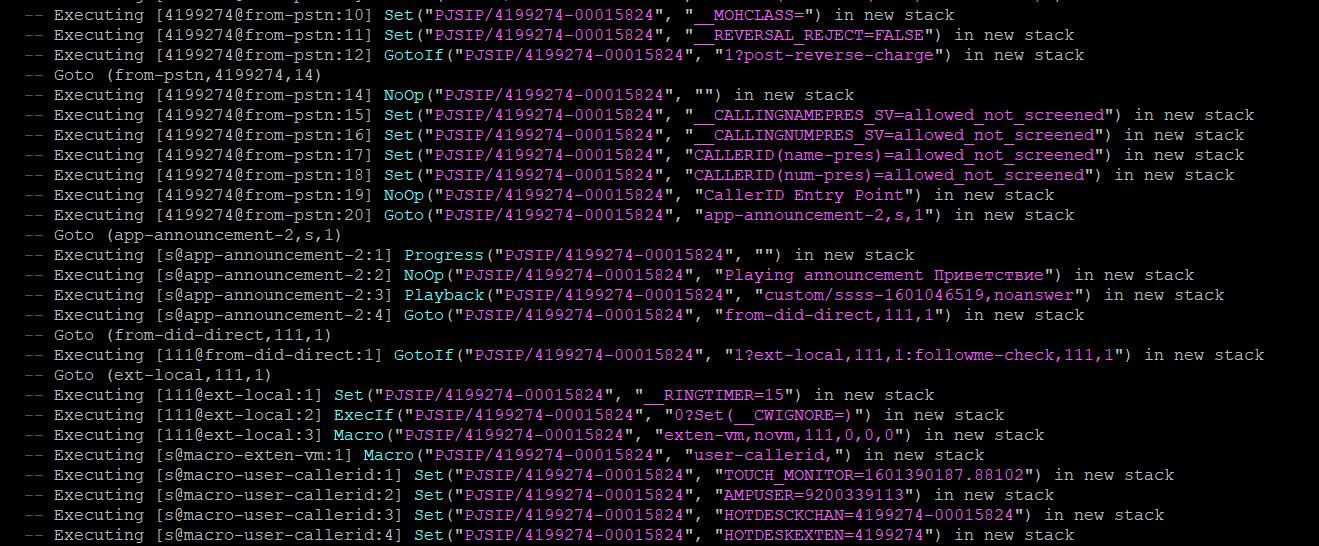

CLI> core show application Playback
-= Info about application 'Playback' =-
[Synopsis]
Play a file.
[Description]
Plays back given filenames (do not put extension of wav/alaw etc). The playback
command answer the channel if no options are specified. If the file is
non-existant it will fail
This application sets the following channel variable upon completion:
${PLAYBACKSTATUS}: The status of the playback attempt as a text string.
SUCCESS
FAILED
See Also: Background (application) -- for playing sound files that are
interruptible
WaitExten (application) -- wait for digits from caller, optionally play music
on hold
[Syntax]
Playback(filename[&filename2[&...]][,options])
[Arguments]
options
Comma separated list of options
skip: Do not play if not answered
noanswer: Playback without answering, otherwise the channel will be
answered before the sound is played.
Я не знаю. В вэб модуле по-русски это стоит птичка Не отвечать в канал.cooller-m@rambler.ru писал(а):Тогда пожалуйста уважаемый ded, можете меня ткнуть носом где поменять в web опцию noanswer?
