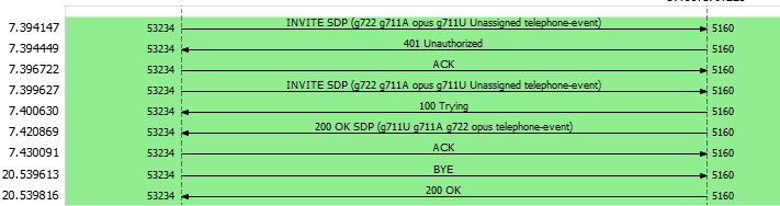

Снял дамп, *60 звонит нормально, в консоли идет что звук проигрывает, а в софтфоне звука нет...
Хлопцы помогите уже!

Вот дамп с пира
sip set debug peer 805
SIP Debugging Enabled for IP: 188.68.188.88

Peer audio RTP is at port 192.168.0.147:58210
Looking for *60 in from-internal (domain 37.60.188.288)

To: <sip:*60@37.60.188.288:5160>;tag=as039f5802
Call-ID: 88254NzRlNWVkNjMwMTI3YzQ2MDAxYTNjZDRlM2Q4YmY3NDQ
CSeq: 2 INVITE
Server: FPBX-14.0.1.14(14.6.2)
Supported: replaces, timer
Contact: <sip:*60@37.60.188.288:5160>
Content-Type: application/sdp
Content-Length: 275
v=0
o=root 913872413 913872413 IN IP4 37.60.188.288
s=Asterisk PBX 14.6.2
c=IN IP4 37.60.188.288
t=0 0
m=audio 18868 RTP/AVP 0 8 101
a=rtpmap:0 PCMU/8000
a=rtpmap:8 PCMA/8000
a=fmtp:101 0-16
a=ptime:20
a=maxptime:150
a=sendrecv
<--- SIP read from UDP:188.68.188.88:65450 --->
ACK sip:*60@37.60.188.288:5160 SIP/2.0
Via: SIP/2.0/UDP 192.168.0.147:65450;branch=z9hG4bK-524287-1---39b10015289c877d;rport
Max-Forwards: 70
Contact: <sip:805@188.68.188.88:65450;rinstance=9e20cf0b908eb762>
From: "805"<sip:805@37.60.188.288:5160>;tag=187cb515
CSeq: 2 ACK
User-Agent: X-Lite release 5.0.3 stamp 88254
Content-Length: 0
--- (10 headers 0 lines) ---
-- Executing [*60@from-internal:6] Wait("SIP/805-0000001e", "1") in new stack
-- Executing [*60@from-internal:7] Set("SIP/805-0000001e", "NumLoops=0") in new stack
-- Executing [*60@from-internal:8] Set("SIP/805-0000001e", "FutureTime=1508332582") in new stack
-- Executing [*60@from-internal:9] Set("SIP/805-0000001e", "FutureTimeMod=2") in new stack
-- Executing [*60@from-internal:10] Set("SIP/805-0000001e", "FutureTime=1508332590") in new stack
-- Executing [*60@from-internal:11] Gosub("SIP/805-0000001e", "sub-hr12format,s,1()") in new stack
-- Executing [s@sub-hr12format:1] GotoIf("SIP/805-0000001e", "0?sub-hr12format,ru,1:sub-hr12format,en,1") in new stack
-- Goto (sub-hr12format,en,1)
-- Executing [en@sub-hr12format:1] Playback("SIP/805-0000001e", "at-tone-time-exactly") in new stack
-- <SIP/805-0000001e> Playing 'at-tone-time-exactly.ulaw' (language 'ru')
-- Executing [en@sub-hr12format:2] SayUnixTime("SIP/805-0000001e", "1508332590,,IM 'vm-and' S 'seconds' p") in new stack
-- <SIP/805-0000001e> Playing 'digits/4.ulaw' (language 'ru')
-- <SIP/805-0000001e> Playing 'digits/16.ulaw' (language 'ru')
-- <SIP/805-0000001e> Playing 'vm-and.ulaw' (language 'ru')
-- <SIP/805-0000001e> Playing 'digits/30.ulaw' (language 'ru')
-- <SIP/805-0000001e> Playing 'seconds.ulaw' (language 'ru')
BYE sip:*60@37.60.188.288:5160 SIP/2.0
Via: SIP/2.0/UDP 192.168.0.147:65450;branch=z9hG4bK-524287-1---4e0c0c051b937a09;rport
Max-Forwards: 70
CSeq: 3 BYE
Authorization: Digest username="805",realm="asterisk",nonce="07dfbf34",uri="sip:*60@37.60.188.288:5160",response="fb7d8c5c40809829f39dd42071d0ee45",algorithm=MD5
Content-Length: 0
--- (11 headers 0 lines) ---
Sending to 188.68.188.88:65450 (NAT)
Scheduling destruction of SIP dialog '88254NzRlNWVkNjMwMTI3YzQ2MDAxYTNjZDRlM2Q4YmY3NDQ' in 6400 ms (Method: BYE)
<--- Transmitting (NAT) to 188.68.188.88:65450 --->
SIP/2.0 200 OK
Via: SIP/2.0/UDP 192.168.0.147:65450;branch=z9hG4bK-524287-1---4e0c0c051b937a09;received=188.68.188.88;rport=65450
CSeq: 3 BYE
Content-Length: 0
== Spawn extension (sub-hr12format, en, 2) exited non-zero on 'SIP/805-0000001e'
Really destroying SIP dialog '88254NzRlNWVkNjMwMTI3YzQ2MDAxYTNjZDRlM2Q4YmY3NDQ' Method: BYE
tel*CLI> sip set debug off
SIP Debugging Disabled
tel*CLI>
Disconnected from Asterisk server
Asterisk cleanly ending (0).
Executing last minute cleanups
