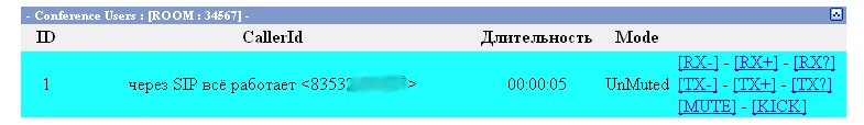

Re: Web-MeetMe сбор конференции по адресной книге
при чем тут контекст
Connected to Asterisk 1.8.7.1 currently running on debian (pid = 28607)
Verbosity is at least 3
  == Manager 'meet' logged on from 127.0.0.1
  == Manager 'meet' logged off from 127.0.0.1
    -- Executing [83532375157@meetme_out:1] NoOp("Local/83532000000@meetme_out-84b7;2", " через SIP всё работает 83532000000 ") in new stack
    -- Executing [83532375157@meetme_out:2] Dial("Local/83532000000@meetme_out-84b7;2", "SIP/oren-kamailio/000000") in new stack
  == Using SIP RTP CoS mark 5
    -- Called SIP/oren-kamailio/375157
    -- SIP/oren-kamailio-000003ef is making progress passing it to Local/83532000000@meetme_out-84b7;2
    -- SIP/oren-kamailio-000003ef answered Local/83532000000@meetme_out-84b7;2
  == Parsing '/etc/asterisk/meet1/meetme.conf':   == Found
    -- Created MeetMe conference 1023 for conference '34567'
включайте дебаг и смотрите как у вас на канале перезаписывается Callerid при уходе в Dahdi

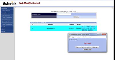

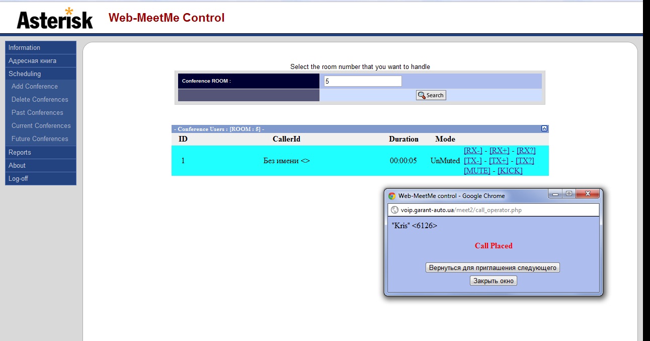

Как интересно получилось,
прописал так как вы сказали,
что имеем,
    -- Executing [6126@meetme_out:1] NoOp("Local/6126@meetme_out-4d3b;2", " Kris 6126 ") in new stack
    -- Executing [6126@meetme_out:2] Answer("Local/6126@meetme_out-4d3b;2", "") in new stack
  == Parsing '/etc/asterisk/meetme.conf':   == Found
  == Manager 'admin' logged off from 127.0.0.1
    -- Created MeetMe conference 1023 for conference '5'
    -- Executing [6126@meetme_out:3] Wait("Local/6126@meetme_out-4d3b;2", "360") in new stack
    -- <Local/6126@meetme_out-4d3b;1> Playing 'conf-onlyperson.slin' (language 'en')
  == Manager 'admin' logged on from 127.0.0.1
      -- Started music on hold, class 'default', on Local/6126@meetme_out-4d3b;1
    -- Stopped music on hold on Local/6126@meetme_out-4d3b;1
Ситуация во вложении. Пишет без имени. Хотя имя я ему передал.
